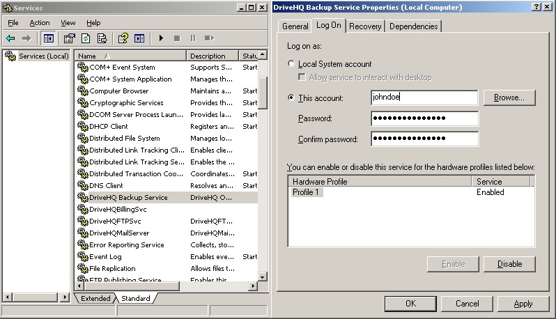

Also, when I try to backup, I get the following error: "Fail to connect network path: Please make sure the service logon account can access the network path. Le chemin d'accès spécifié est introuvable." The last part says "File path not found" in my Windows language. I've tried specifying different folders to see if it was a problem with my own settings on that one folder, but it's still not working.
DriveHQ Online Backup 4.0 is designed for business backup; it has more features and more controls, so it is indeed a little bit more complicated. However, the basic features are very simple; if you want to backup a folder on your local PC, it should only take a few seconds to setup the backup task.
Now in your case, the main issue is about backing up a network shared folder.  Starting from DriveHQ Online Backup 4.0, the software runs in Windows Service mode by default. Under service mode, the backup process runs even if nobody is logged on your computer (of course the computer must be powered on).
Now if you are familiar with Windows (or NT) Service, you know that a service process logs on as "LocalSystem" by default. This is a special local PC account, which cannot access the network folder. Thus it cannot backup your network folder. Now it is actually very easy to configure it to backup network folders - you just need to change the service logon account to your Windows Logon account. You can do so from Control Panel -- Services (Or from Control Panel --> Administrative Tools --> Services, dependent on the type of Windows OS you use). You can find a service with the name: "DriveHQ Backup Service", edit it as below:
